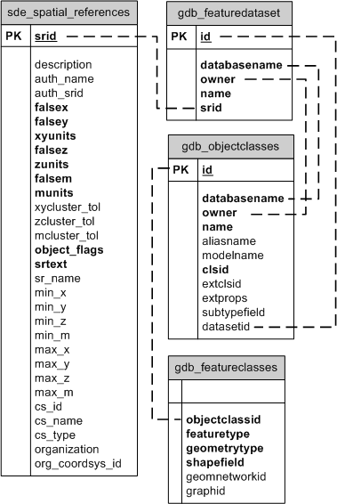

Feature datasets in a PostgreSQL DBMS
In the database, feature datasets are virtual collections of feature classes. They are grouped together by a common dataset ID, which is maintained in the gdb_featuredataset system table and associated with the gdb_objectclasses system table.
For the landbase feature dataset example, the feature class, parcels, is linked to the landbase feature dataset through the gdb_objectclasses table. Dashed lines indicate implicit relationships between columns.
Feature dataset system tables in PostgreSQL
Because feature datasets are a virtual collection of objects, feature classes in feature datasets are just like stand-alone feature classes in that they have their own records in the gdb_featureclasses table and all the other tables associated with feature classes (sde_layers, sde_table_registry, sde_geometry_columns, sde_column_registry, sde_spatial_references, and gdb_object_classes). Since feature classes associated with feature datasets are database objects in their own right, they cannot have the same name as other tables or stand-alone feature classes in the same schema in the database.
Topologies, relationship classes, geometric networks, network datasets, terrain datasets, schematic datasets, and cadastral fabrics utilize additional system tables. These are described in separate topics that can be accessed using the links at the beginning of this topic.
