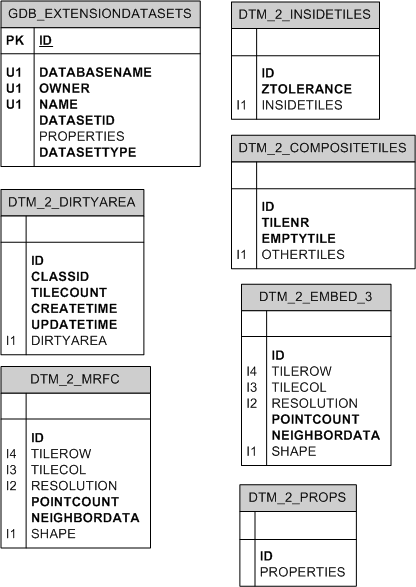

A record is also created in the GDB_EXENSTIONDATASETS table to track the terrain dataset. The ID in the names of the DTM tables come from the ID field of the GDB_EXTENSIONDATASETS table.
As mentioned, terrain datasets are tracked with the same system tables as feature datasets. The additional tables for the napa_sub terrain dataset.
Terrain dataset tables in DB2
