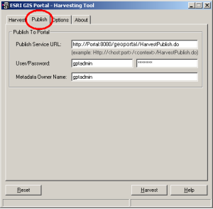

Publish through the Harvesting Tool
The Harvesting Tool connects to Geoportals using information that a user provides through the Harvesting Tool's 'Publish' tab. The Harvesting Tool connects through the Portal's Publish Metadata service. Connections enable the Harvesting Tool to publish harvested records to the Geoportal, and also ping the Geoportal database to retrieve registered repository information. This section describes parameters on the Publish and Options tab with which users should become familiar.
Input Fields for the Publish Tab
Publish Service URL: URL to the Portal Server, e.g. "http://<Geoportal9.3.1_ServerName>[:port]/Geoportal9.3.1_Application_Name/HarvestPublish.do"
User/Password: user name and password for an administrator or publisher account registered in the GIS Portal
Metadata Owner Name: used when performing a publish operation. The name of the user who will own the published metadata. If you load a repository using the "Configure from DB" dialog on the Option tab, this will populate with the metadata owner associated with the repository when it was registered.
NOTE: If this parameter points to a different user than the user whose account information is specified in the user/password fields, the user specified in "Metadata Owner Name" takes precedence on metadata ownership.

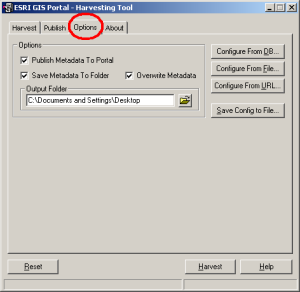

Input Fields for the Options Tab
Publish Metadata To Portal: Checking this option specified the user's intent for harvested metadata to be automatically published to the Geoportal. If this option is checked, then it is required for all of the fields on the "Publish" tab to be populated.
Save Metadata to Folder: By checking this option, harvested records will be written to a specified folder. When this option is checked, two new settings appear:
Overwrite Metadata: Check this box if you want to overwrite any metadata records that already exist in the specified Output Folder
Output Folder: the folder in which the harvested metadata records should be saved
Configure From DB: Opens the "Load Configuration from Database" dialog, retrieving a list of metadata repositories that have been registered in the Geooortal database. The Publish Service URL and User/Password fields on the "Publish" tab must be populated for this connection to be successful. Once the dialog has loaded, select a repository from the list and click the Load button. The repository settings, as they are stored in the Geoportal database, will automatically populate on the Harvest tab.
Configure from File: Allows the user to configure a harvesting session from information stored in an XML file local to the machine where the Harvesting Tool is installed. The file can be created using the Save Config to File button, and will load settings for the Harvest, Publish, and Options tabs.
Configure from URL: Allows the user to configure a harvesting session from information stored in an XML file available on a web server. The file is the same as the one created with the Save Config to File button, but is exposed on the web instead of saved locally.
Save Config to File: Saves the current Harvest, Publish and Option settings to an XML file that can be used in a new harvest session with the Configure from File or the Configure from URL option.
