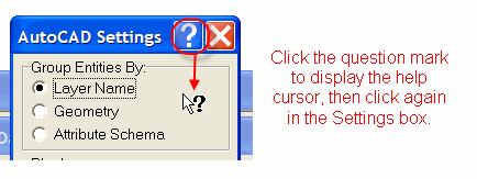

For Settings Box Help: Press the F1 button on your keyboard, or click the question mark in the upper-right portion of the Settings Box.
