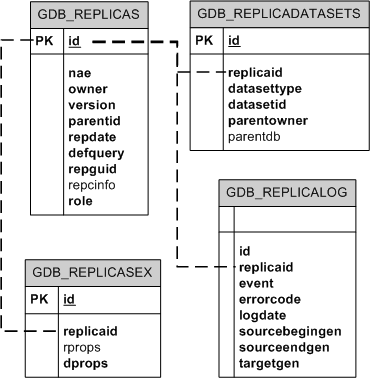

Replica tables in a SQL Server DBMS
Before datasets can be replicated, they must have a global ID column and they must be registered as fully versioned (not registered with the option to save edits to base). Therefore, in the database, the business tables of any datasets that will be included in the replication will have a GUID column, and delta tables exist for each of these datasets.
Replicas are tracked in the database using the following ArcSDE geodatabase system tables. Click the table names to link to their descriptions.
GDB_REPLICADATASETSGDB_REPLICALOGGDB_REPLICASGDB_REPLICASEX
The tables are related as follows:
When synchronization is performed between two geodatabases, each session creates a local temporary table to track dataset lineages.

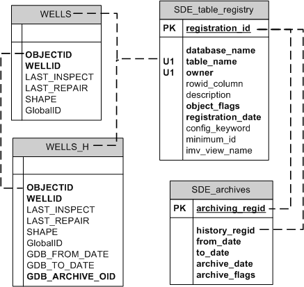

Archiving tables in a SQL Server DBMS
When a table is enabled for archiving, an archive class is created. This is a copy of the business table and contains all the same fields plus three new fields: GDB_FROM_DATE, GDB_TO_DATE, and GDB_ARCHIVE_OID. For a description of how these fields are populated, see
The archive process.
The name of the archive class table is the same as the original business table name with an underscore and H appended to it. For example, if a feature class named trails is enabled for archiving, an archive class, trails_H, is created in the schema of the owner of the feature class. The archive class table is read only, stores changes saved or posted to the DEFAULT version of the geodatabase, and is not deleted if its corresponding dataset is unregistered as versioned or deleted. If an archived dataset is unversioned or deleted, the archive class is converted to a temporal table and can still be queried. See
Working with the Geodatabase History Viewer for details on viewing different historical versions.
When changes are made to the schema of a dataset that is enabled for archiving—for example, if a field is added or deleted—these changes are automatically added to the corresponding archive class.
NOTE: Never directly alter the schema of an archive class.
Also, when a table is enabled for archiving, a record is added to the SDE_archives table. This record stores the registration IDs of the table that was enabled for archiving and its associated archive class table. For further information on the SDE_archives table, see
System tables of a geodatabase in SQL Server.
The following shows a business table—WELLS—enabled for archiving, its corresponding archive class table, and records in the SDE_archives table.
